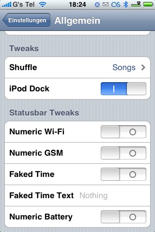

ich hätte hier z.B. eine interessante Variante der Extended Preferences. Funktioniert auch mit den Boss Prefs zusammen. Bei mir unter 1.1.4
Die Funktionen sind:
Ach ja, Wichtig: If you have a version before 1.3 installed: Uninstall it before installing the newest version!
What is this?
This package will modify the already existing settings application of your iPhone/iPod Touch. It reorganizes several things and adds tweaks.
Reorganized
The "General"-menu was reorganized for better and faster navigating through your settings.
Album shuffle
You can now switch between normal and album shuffle. The shuffle-button of your musicplayer gets assigned with the chosen shuffle-mode automatically.
Numeric values
You can switch numeric values for WiFi-strength, GSM-strength (iPhone only) and battery load on and off. You can switch between icon and number by just tapping an icon/a number in your statusbar.
Statusbar texts
You can set your own texts that will be shown instead of your time (iPod & iPhone) or your carrier-text (iPod only since the iPhone has a carrier-logo) in the statusbar.
System sounds
There is a new "Sound effects"-menu which allows you to decide which system sounds you want to hear (for example you can en-/disable clicks when unlocking or when typing on the virtual keyboard, a.s.o.).
Improved display settings
Your "Brightness"-setting now has the numeric value of your brightness next to it to make it easier for you to set a specific brightness. Additionally, you now have more options to set your auto-screenlock-time to (for example 30 seconds or 10 minutes). The best thing: You can now set the screens dim-time seperatly. So you can decide when your screen should dim and when it should go off to sleepmode!

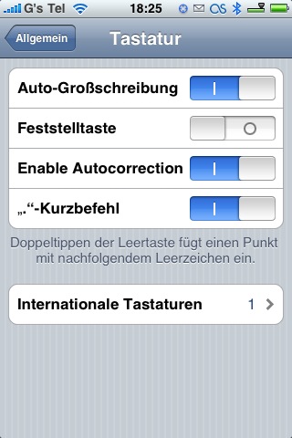

Auto-Correction? Screw that!
You can now disable the iPods/iPhones auto-correction-feature within the "Keyboard"-menu. Get what you type in, not what your device wants you to type in!
Power statistics
Known from the iPhone, you now get the power statistics for your iPod. Even though they don't work well on the iPod, they can still be informative and useful.
More
Discover the settings to find even more stuff! Maybe I forgot some things, since there are so many new ...
Sind noch einige Sachen mehr. Hoffe das ist es was Du suchst.

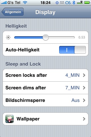

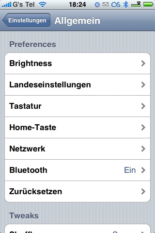

Viel Spaß Biggrin[attachment=1169]

ich habe deine Variante mal installiert. Scheint ähnlich aber doch anders zu sein Smiley
Unter Einstellung fehlt das Interface, dafür gibt es eine neue Unterteilung in Gruppen und die Features welche unter interface waren sind nun woanders.

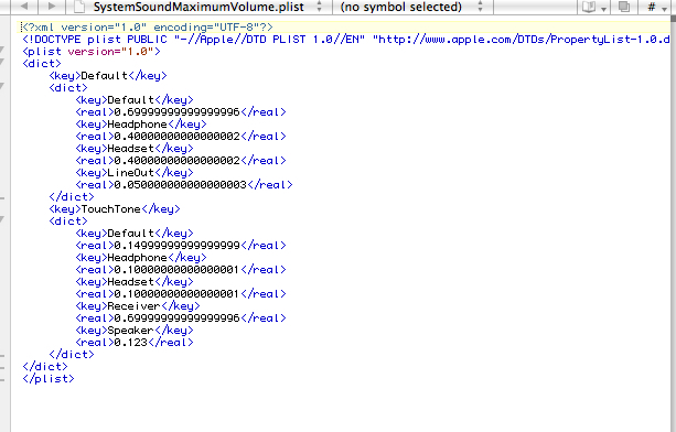

Als ein Beispiel was man bereits mit .plist files anstellen kann, möchte ich anhand der Lautstärkegrundeinstellung demonstrieren. Die über alle Firmwareversionen etwas schwache Tonausgabe des iPhone ist ja bekannt.
1. Über Terminal und Eingabe von:
ssh@IP Adresse Deines iPhone,
in Dein iPhone einlocken. PW: Alpine, soweit nicht geändert
(Vorsicht, nur über die von Saurik, Cydia Packer, beschriebene Vorgehensweise ändern)
2. Dann per ssh in den Ordner:
cd /System/Library/Frameworks/
oder über ein Tool wie Transmit (Mac) in obiges Verzeichniss gehen:
3. Unter ssh mit ls das Verzeichnis auflisten und die Datei Celestial.framework entweder auf Deine Festplatte kopieren oder eine Kopie mit einem anderem Namen, im selben Verzeichnis speichern (z.B. Celestialframework.bak). Wichtig! falls was schief geht, hat man immer eine Sicherheitskopie.
Das gleiche mit Transmit ist wohl selbsterklärend.
4. Die Kopie Celestial.framework öffnen und dort die Datei SystemSoundMaximumVolume.plist
mit BBEdit oder einem guten Texteditor öffnen. Müßte dann in etwa so aussehen (es sein denn, es besteht schon ein Audio Fix über den Installer)
Wie man deutlich unter Default sehen kann, steht dort 0.69999999999..6
5. Diesen Wert z.B. auf 9.999999..6 (gleiche Anzahl von Stellen) ändern.
6. Dann die so veränderte Datei als SystemSoundMaximumVolume.plist
speichern und in Celestial.framework einfügen. Nicht vergessen immer ein Backup der Originaldatei behalten.
7. Celestial.framework wieder aufs iPhone übertragen.
8. Anschließend das iPhone neu booten
9. Wenn alles richtig gelaufen ist, sollte die Maximallautstärke des iPhone nun
höher sein.
Dies ist sicher noch kein richtiges Programmieren. Wohl eher eine Form des Patchens. Aber so lässt sich das ein oder andere am eigenen iPhone verändern und man bekommt einen Eindruck, wie das ein oder andere Funktioniert.
