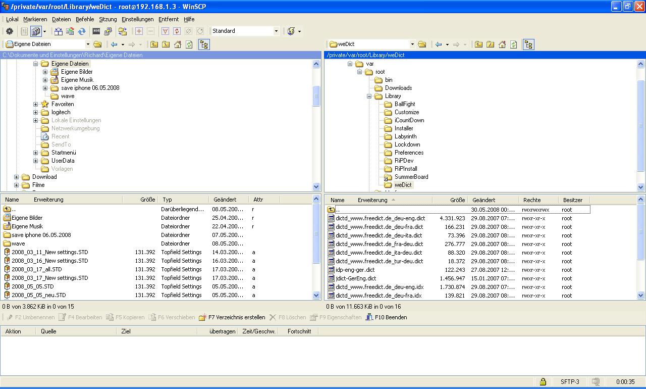

hier eine anleidung. ich hoffe in englisch ist auch ok.
weDict is a native iPhone dictionary available on Installer. The most recent version is at o.6.1 using http://app.weiphone.com/installer/ as the Installer source. This new version supports user selectable dictionaries to limit your results by pressing the "i" button in the top right hand corner. Various dictionaries are available from Installer or at the StarDict website. Manually downloaded dictionaries need to be extracted. Then rename the following *.dict.dz to *.dict.gz. Then extract again and upload via sftp the resulting *.dict and *.idx files to /private/var/root/Library/weDict folder on your iPhone. Limited speech pronunciation also works but with a hefty 200mb file size. Sound files can be downloaded here and uploaded via sftp also to the /private/var/root/Library/weDict folder on your iPhone. The weDict skin can be downloaded below, extract, and upload the images to your Applications/weDict folder.

versuch mal nicht mit winrar zu enpacken sondern mit winzip. "extract here". dann sollte es gehen.

PS: Falls ihr 1.1.3 nutzt den Pfad: root/private/var/MOBILE/Library/weDict nutzen. In der Anleitung ist der für 1.1.2.
